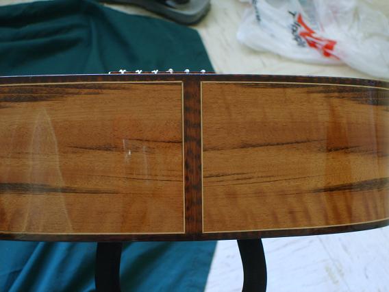

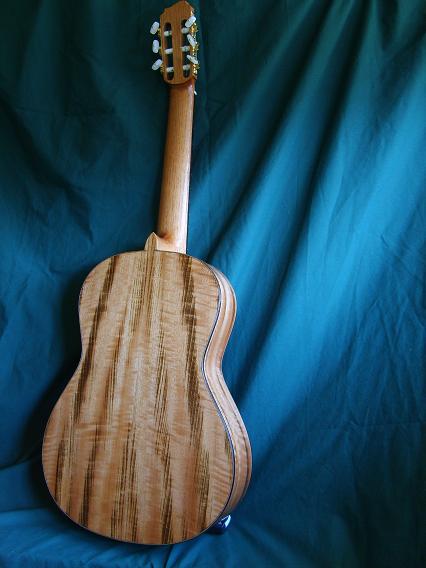

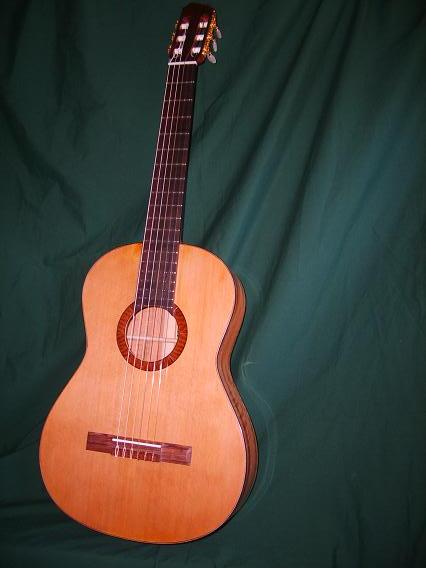

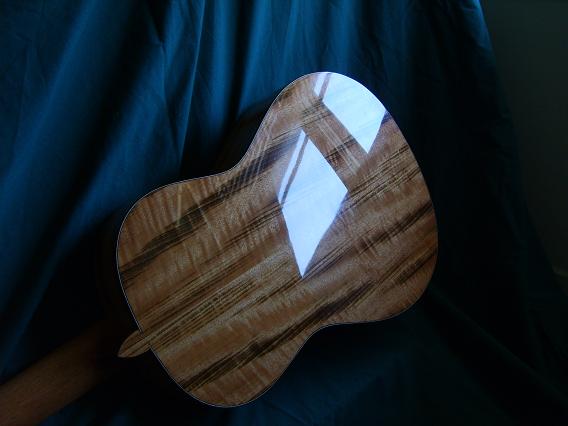

I just finished my 4th build, this was my first classical. It started out as an exercise in building a classical, so I planned on using stuff I had on hand, but as it started to come together I decided to spice it up. Based on the Romanillos plan with some variations. The vitals are:
B&S-Curly Goncalo Alves
Top-Western RC
Neck-Spanish Cedar
Fretboard- EIR
Bridge-Honduran RW with Snake wood tieblock
Rosette/Binding/End graft- Snakewood
Scale-650mm
Tuners- Gotoh
Finish-Mcfadden Nitro over epoxy pore fill
I like the sound, it's pretty well tonally balanced, and has plenty of sustain. But I have very little experience with Classicals so I don't have much of a base of comparison.
This pic is a little washed out, the other shots are more representative of the color.

That is beautiful!!!!
The construction looks flawless. So does the finish.
Beautiful wood selection

That's incredible for a 4th guitar, or even a 50th guitar. Great work! I like everything about it. Great wood choices, and perfect finish. Keep building, or start learning to play classical

Wow, I had never been that taken with Goncalo Alves, but that is very sharp. Like Andy said, it looks flawless!
Great finish!

Congratulations...very pretty. great Goncalo Alves. The wood choices look really good together.

Wow! What a fantastic looking guitar Matt!
That finish does look flawless!!!

Very elegant and nice combo of woods used Matt, the finish really looks perfect, is this nitro?

Serge, It is Nitro
